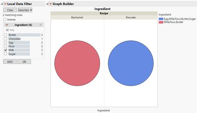

For example, I want to see all the recipes that use Milk. If I add a local data filter on the recipe, the pie plot won't display all the ingredients for the Bechamel and Pancake.
What I would like to have as an output is something like this :
Is there an easy way to do that, without writing some JSL ? We can modify the table or work with the Graph Builder.

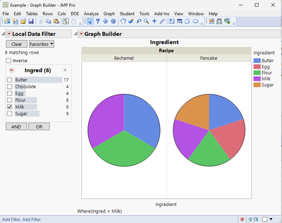

I'm not sure if you can do this in JMP16 (I'm using JMP18), but you can create multiple response column of your Ingredients
Table attached with table script

If you modify the data table with new rows and a new column, I can get it to work in JMP 16.  You need to create a new row for each combination of ingredients for each ingredient in the recipe.  So for Bechamel which has Milk, Flour and Butter
it has to be expanded to
And here is a script that will generate the expanded data table

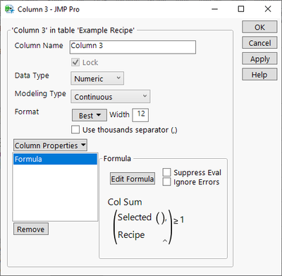

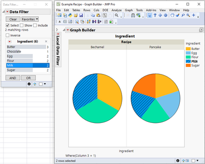

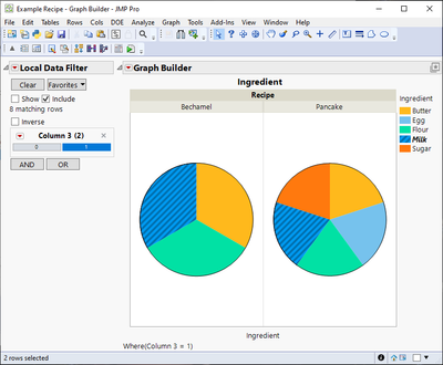

Scripting is also an option but you said you wish to avoid it, so here is maybe an option which might work in JMP16 (it can be a bit clunky to use due to utilizing selection row state). If you can use Data filter instead of local data filter, you can do something like this
Create formula column like
Col Sum(Selected(), :Recipe) >= 1
Create Data filter (NOT LOCAL DATA FILTER) with ingredient
Create your graph WITH local data filter using your newly created formula column and set the value to 1
You can then collapse the local data filter and organize the windows side by side
One a bit annoying thing here is that there will be a selection and it will mess up if something is selected from the table / outside of data filter.
-Jarmo
