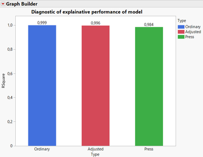

In MODDE, we find a valuable capability for model validation, allowing us to scrutinize and validate the model used to run and analyze a Design of Experiments (DoE). This functionality is presented in an intuitive graphical user interface (GUI) manner, facilitating a seamless user experience Please refer the attached image or to minute 21:15 in the linked video for further details - https://www.youtube.com/watch?v=UTYRpStJDE8
However, I've been exploring JMP for similar functionalities, and I am yet to discover a straightforward method for model validation. While JMP is excellent for executing DoE analyses, it appears to lack a built-in mechanism to validate the model it employs during the analysis.
Could you kindly shed some light on whether JMP offers a feature similar to MODDE for validating the DoE model? If so, I would greatly appreciate guidance on how to access and utilize this feature.

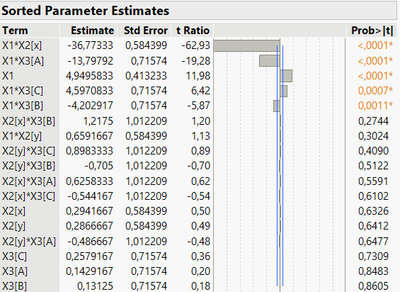

Note also that depending on the "emphasis" used in "Fit Model", you may have access to some of the plots you would like to see. For example, when the model emphasis is "Effect screening", you can display "Sorted Parameters Estimates" (accessible in the red triangle options of "Estimates"), which offers a synthetic view of statistical significance and effect size :
Concerning your specific plot, you can recreate it with the Graph Builder, as R² and adjusted R² are available in the "Summary of Fit" panel (righ-click on it, and you can directly create a datatable from it), and R² and R² PRESS (or Q²) are available in the "Press" panel (in the red triangle, go to "Row Diagnostics", then "Press") so you can also create a datatable from it.
From then, combine the tables and you'll have a similar plot using Graph Builder :
You can calculate Validity and Reproducibility from MODDE in JMP based on the formula from : https://www.sartorius.com/download/544636/modde-12-user-guide-en-b-00090-sartorius-data.pdf
You may not be able to calculate these metrics if you are not able to conduct this test : Lack of Fit

PieAnteater793
Level II
Re: Model Validation in JMP Statistical Software as compared to MODDE
Hi @Victor_G ,
Thank you for hitting the nail on the head with your solution. The hyperlinks really helped. Much appreciated!
