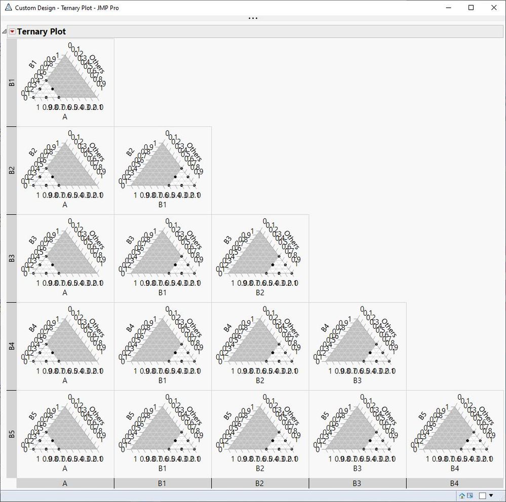

@Mark_Bailey I used your script and changed just the upper limits of my factors (as below). The design stops working as I need - maximum of 2 B factors.
I don't understand why... I don't see in your Custom Design any condition to tell to JMP we can only use 2 B's. Can you help?

Re: Mixture DOE - how to limit number of ingredients in final formula?
I used the model order (2) to force binary blends but not require ternary blends or higher otherwise. I got this with the original proportion ranges:
Notice that in every combination of two components and others a simplex is achieved so that only the pure blends (vertices) and binary blends (edge centroids) are required. You restricted the proportions a lot:
JMP must now create higher order blends (higher than binary blends) in order to salsify the constraint that the sum is 1 and to maximize the optimality criterion.
Why did you change the range of these proportions?

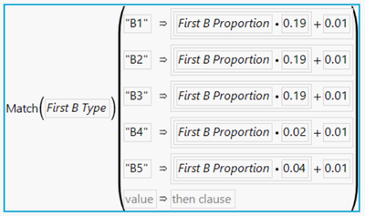

Create a new column called "True First B Proportion". It will be a formula column with this formula:
Match( :First B Type,
	"B1", :First B Proportion * 0.19 + 0.01,
	"B2", :First B Proportion * 0.19 + 0.01,
	"B3", :First B Proportion * 0.19 + 0.01,
	"B4", :First B Proportion * 0.02 + 0.01,
	"B5", :First B Proportion * 0.04 + 0.01,
	Empty(), Empty()
(You can see it graphically in the earlier post). This is simply taking the First B Proportion multiplied by the range for that specific B component + the lower bound of 0.01.

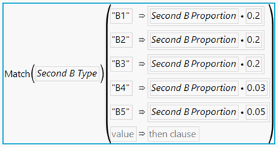

We now do a similar thing with the second B component. That column will be called "True Second B Proportion" and this formula is:
Match( :Second B Type,
	"B1", :Second B Proportion * 0.2,
	"B2", :Second B Proportion * 0.2,
	"B3", :Second B Proportion * 0.2,
	"B4", :Second B Proportion * 0.03,
	"B5", :Second B Proportion * 0.05,
	Empty(), Empty()

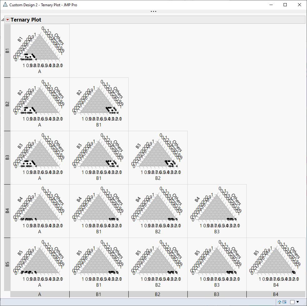

@Dan_Obermiller, thank you for your clear and detailed explanation, I was able to reproduce all steps!
However, there is an issue: the True B proportions are very low and the final mixture (A+ True First B+ True Second B) should be equal to 1 and it is not...total of 3 mixture factors ranges from 0.62 and 1.00.
	Empty(), Empty()
	Empty(), Empty()

I was able to reproduce all steps and I changed the formula of the True Second B Proportion as you suggested because our upper limits area already very challenging. In case we find some of these upper limits are not feasible and we are not able to measure the results, should we keep results in blank or what should we do?
