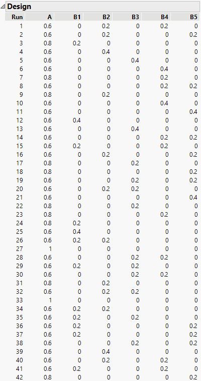

Re: Mixture DOE - how to limit number of ingredients in final formula?
What about this design?
Here is the script to set up the Custom Design platform as I did:
DOE(
	Custom Design,
	{Add Response( Maximize, "Y", ., ., . ), Add Factor( Mixture, 0.6, 1, "A", 0 ),
	Add Factor( Mixture, 0, 0.4, "B1", 0 ), Add Factor( Mixture, 0, 0.4, "B2", 0 ),
	Add Factor( Mixture, 0, 0.4, "B3", 0 ), Add Factor( Mixture, 0, 0.4, "B4", 0 ),
	Add Factor( Mixture, 0, 0.4, "B5", 0 ), Set Random Seed( 343091112 ),
	Number of Starts( 305 ), Add Term( {1, 1} ), Add Term( {2, 1} ),
	Add Term( {3, 1} ), Add Term( {4, 1} ), Add Term( {5, 1} ), Add Term( {6, 1} ),
	Add Term( {1, 1}, {2, 1} ), Add Term( {1, 1}, {3, 1} ),
	Add Term( {1, 1}, {4, 1} ), Add Term( {1, 1}, {5, 1} ),
	Add Term( {1, 1}, {6, 1} ), Add Term( {2, 1}, {3, 1} ),
	Add Term( {2, 1}, {4, 1} ), Add Term( {2, 1}, {5, 1} ),
	Add Term( {2, 1}, {6, 1} ), Add Term( {3, 1}, {4, 1} ),
	Add Term( {3, 1}, {5, 1} ), Add Term( {3, 1}, {6, 1} ),
	Add Term( {4, 1}, {5, 1} ), Add Term( {4, 1}, {6, 1} ),
	Add Term( {5, 1}, {6, 1} ), Set Sample Size( 42 ), Simulate Responses( 0 ),
	Save X Matrix( 0 ), Make Design}
The minimum number of mixtures is 21. I used the default number of 42. The choice is yours, of course.
slscolep
Level II
Thank you @Mark_Bailey
This design suits our needs, I just need to adapt it because our upper limits of B1-B5 are not 0.4.
Where can I learn more about inserting script to set up the Custom Design? Is this replacing the Custom Design window to fill in the responses and factors?
statman
@Dan_Obermiller wrote a good introductory paper some years back "Tips on JMPing into Mixture Experiments".
No, I still used the Custom Design platform. I only used the script as a way to convey my work to you and save you the trouble of setting it up again or me the work of explaining how to set it up.
I clicked the red triangle next to Custom Design and selected Save to Script command when I finished this example. It was easy for me to include in my reply. It was (I hope!) easy for you to copy from my reply, enter in a new JMP script window, and run to obtain the same Custom Design as mine.
