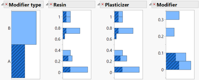

Following this approach I created a "Big Design" of 2000 runs that obeys the constraints that you have. Then used this as a candidate set for the smaller 40-run Custom Design. (Both designs attached). I think this approach would work for you?
You can see that it obeys the constraint you stated:
