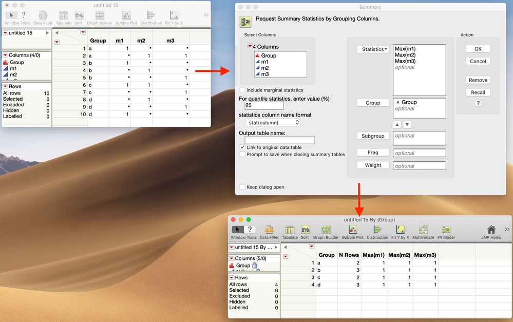

Hi! I've got a similar problem. I'd like to merge rows with the same time value without creating new columns. So in the example below rows 75629 and 75630 would become one row with more data in it and 75631/2 would move up one number. Is there a way to do something like this?
Jeff_Perkinson
Re: Merging Rows
If it's a matter of dealing with the missing values for those columns you might try using Tables->Summary to group by your datetime column and use the Max statististic for all those columns.
-Jeff
plfazeli
Level II
Re: Merging Rows
You mentioned this in a post a few years ago "I've had data sets where there were multiple rows that needed to be "combined" into a single observation.  How to do it depended on whether I wanted the average or sum (or....) of those rows."
Can you tell me how to do this? (I would want a sum of the value in a variable for unique subject IDs with multiple rows of data)
txnelson
Re: Merging Rows
Use the Summary platform
Tables=>Summary
Jim
