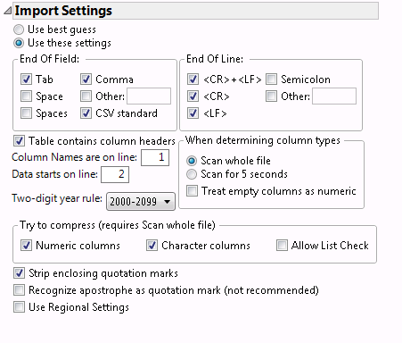

Please know, though, that you can often speed up the text import process if you are fairly confident of the layout of the data ahead of time.  If you open the file using the "Text Import Preferences" rather than "Best Guess", it will speed up import.  Also, in the Preferences panel for Text Data Files, if you select "Scan for 5 seconds" in the "When determining column types" it can help if you don't have thousands of columns.

I was referring to File->Preferences->Text Data Files->Import Settings for the 5 second preference. For the open operation, Under File->Open on Windows, you can select between "Data, using Text Import Preferences", "Data, using best guess" and others.

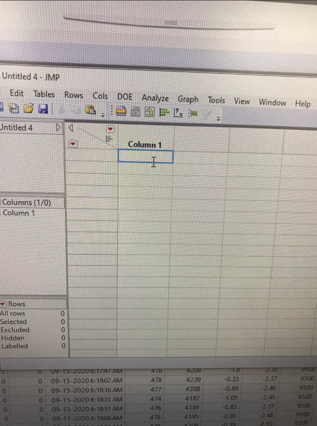

I know its quite long time, but I just found an solution to this matter and want to share it.
For JMP 15, when paste data from Excel file to JMP table sheet. If you select the child row like this, it will take forever (not responding).
But if you select the head of the column (column 1 in the sheet) like this, it will go smooth:
Simple, right?
