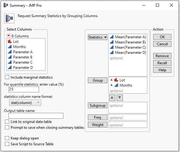

All you need to do is to run
     Tables=>Summary
and select the following settings
The data table produced will have the results you want.

txnelson
Re: Merging Rows based on two column conditions
     Tables=>Summary
Jim

Ah thank you for this solution, I did not think to use the Mean() statistic in the summary table.
