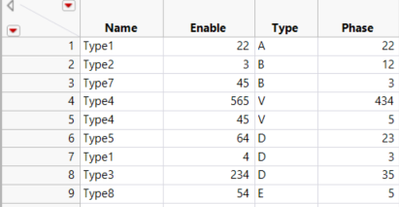

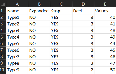

I have two files:
1st file is the Excel
2nd file is the JMP
1st file
2nd file:
I am trying to write a script which can copy the Column Name "Values" from the excel file and past in the 2nd JMP file so my final output will look something like this:
Any suggestions on writing script in JMP?

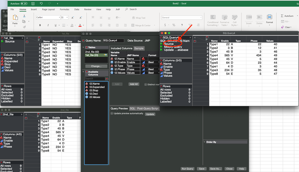

Hi @Jackie_,
Using JMP Query Builder will allow you to blend data from multiple sources as you describe, Excel and JMP, JMP and a database table, JMP, Excel and database tables.
The scripts will write themselves.
Import the data with Excel Wizard. Right-Click on green-triangle next to the Source script to view the script.
JMP QB Blending multiple data sourcesJMP QB Blending multiple data sources
Use JMP Query Builder as described in your previous post merging a column from one JMP file to another JMP file.

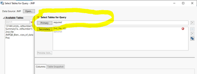

Jackie_
Level VII
Re: Merging Column from excel file int JMP data file
How can I import xlsx file in Primary section ?
Jackie_
Level VII
@stan_koprowski How can I import xlsx file in Primary section ?
stan_koprowski
Hi @Jackie_,
You can use the Excel Wizard using File-->Open.
See Importing MS Excel file in the help documentation for additional details.
