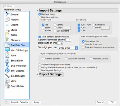

Thanks Jeff. This is very helpful. I also like to set the preferences in reading csv file to be different that default. Can one add the preferences for header row and data rows in the script? Thanks
Jeff_Perkinson
Re: Merge csv files with different columns names
Well, you can change the defaults in Preferences.
But, yes, you can change the import options in JSL for an individual file. The easiest way to get the JSL for a specific file is to import it with Preview. The resulting data table will have a Source script with the JSL for that file.
-Jeff

Thanks Jeff. I was able to use the open file and set column name start and data starts and workfine.
dt = Open( filenow, private,
Column Names Start( 2 ),
Data Starts( 3 ) );
