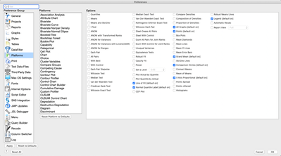

The oneway analysis platform does not respect the preference setting of means diamonds.  I have deselected it in preferences and it always is presented, requiring me to turn it off.

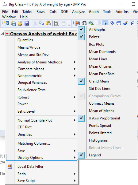

The preference here is working as designed. The preferences available correspond to the options available in the red triangle menu and control which of those options is on as the platform is initially launched.
Some of menu options activate more than one other option, as is the case here for the Means/Anova option. It turns on the Means Diamonds and JMP provides no option to specify otherwise.
I have recorded your request to try to provide a preference to not display the means diamonds with the Means/Anova option.

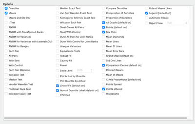

My understanding in preferences is that it allows me to set the graphic elements that I would like by default to be included.
To that end I have made selections including Jitter on and turned others off such grand mean line.
When I do a oneway analysis the points are jittered as requested, but the means diamonds are INCLUDED. I then have to turn them off every time by going to the red triangle and going to display options and deselecting means diamonds.
Maybe I am confused about the meaning of preferences and I assumed that this would control the default display when using that platform.

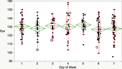

I do see it when I launch oneway. That is crux of my issue. I have set a preference for oneway analysis and when with means diamonds deselected I still get it as is show in my screenshot. I had first report this bug to JMP to the best of my recollection in about 2003.

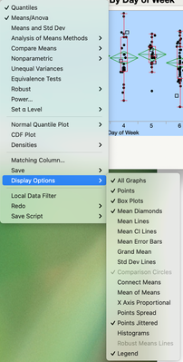

What I mean is exactly launch Fit Y by X and I get means diamonds. The first display of the graph without selecting any means/anova tests from the disclosure triangle. I think what is happening if means is also selected in preferences then the means diamonds preference is ignored. You can further go to the disclosure triangle and deselect means diamonds, but since I have that set in my preferences I would most kindly request that I can have BOTH means selected and means diamonds deselected and get that result as the preferred graph when I do Fit Y by X with a categorical X and continuous Y.
