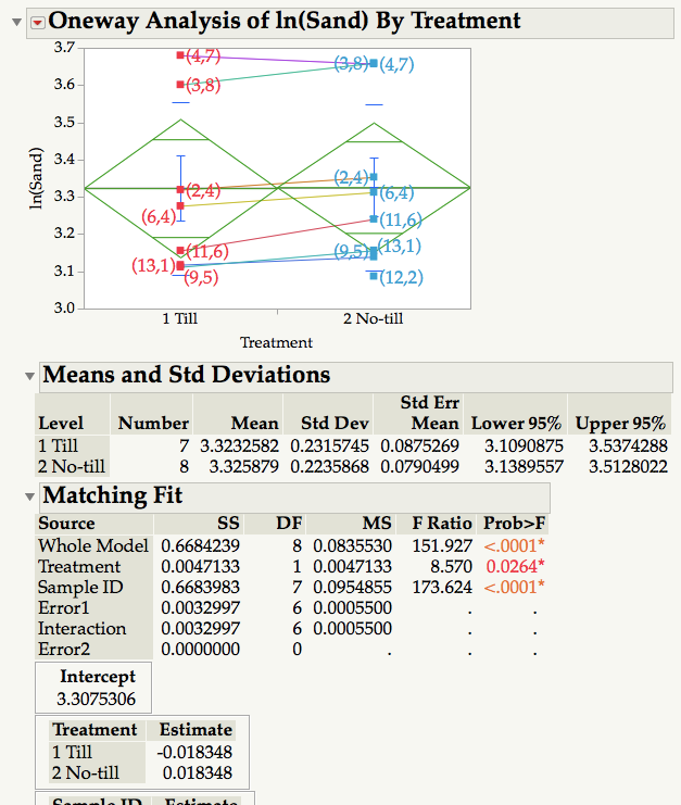

I ran a matching comparison between two sets of measurements (Platform: Fit Y by X) using Sample ID as matching variable and Treatment as grouping variable.  Obviously, the objective is to see if Treatment has an effect on the dependent variable.  Results show that Treatment is significant (p = 0.03) whereas the mean diamonds and common sense indicate it is not.  Omiting the non-matching observation (12,2) from the No-till treatment so that both samples have 7 measurements does not change the result.  What am I missing?

There are several methods to complete a matched pair, or paired analysis in JMP.  The Anova Matched Pairs analysis displays the data with its own scale.  The largest effect in your model is Sample ID (or block).  After removing the Sample ID effect, the average difference in the Till methods is 0.036696 = (0.018348 - -0.018348). The Sum of Squares, SS, of the differences is 0.0047133 (since there is only 1 degree of freedom, this is also the MS). And the MS error is 0.00055 ( the sqrt is an estimate of the std dev of the differences). The F ratio with 1 and 6 degree of freedom is 8.56963 (8.570) which is statisticially different from zero.
The reason the treatment effect is not visible in your display is because the ID variability is more than 100x of the treatment effect. Below I'll document a couple of alternate methods, which depend upon how you table is organized.
  1. Each row represents a pair with 2 columns, 1-Till and No-Till. (This is often called the paired/mulivariate/correlation layout. Compute the difference and analyze the differences to test if equivalent to zero. I like to plot the differences by ID and use Distribution to test if the difference is zero.
  2. Same table layout, use Fit Y by X use No-Till for Y and 1-Till for X. Then request a paired t-test. To do this, hold down the SHIFT key then select the red menu, and the paired t-test option is visible.
  3. Table is stacked, with a column for Sample ID and another for Treatment. (This is often called the ANOVA layout).  Use Analyze Fit Y by X, Y is the response and X is the treatment, then select matched pairs and select the ID column. This is what you used.

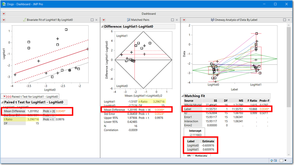

I do not have your data so I will use Dogs.jmp to demonstrate the 3 JMP platform methods displayed in a single dashboard.  Note:
  • all three have the same statistical significance 0.0049
  • two use the t-test (3.29676) and the third is an F ratio (10.868) which is the square of t. An F with (1, df) degrees of freedom is the square of a t statistic with df degrees of freedom.
  • the average difference (1.20195) is equal to the difference of the 2 treatment estimates.
  • the 3rd analysis was achieved by stacking LogHist0 and LogHist1 the stacked column is called Data and the variable name is called Label.
  • The first two methods show a gray line, representing the test: the line Y==X and Diff==0. Both are outside the 95% confidence intervals, hence statistically significant.
All of these graphs are in the original scale of the Dogs.jmp sample data, which is okay since the treatment effect is larger that the ID (blocking) effect.  However, these pictures still are not my preferred display. See below. image.pngUsing the Dogs.jmp layout with 2 columns compute the paired difference (already in the table). Now use Distribution to test  if the mean is zero. Also check for approximate normality of the differences.  Note the T-test of the mean compared to zero is the same t-statistic from the first 2 tests above. However, note the data is not normal (elongated box plot and data gaps).  Plot the differences by ID and other factors in the data. In this data set, Drug and dep. This type of picture can detect outliers and other effects.
