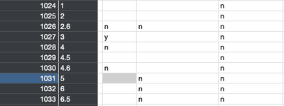

My problem is that by using that formula, jmp replaces my empty values with "n", and I cannot think of any way to modify my formula so that empty spaces remain empty.
Bildschirmfoto 2021-07-06 um 16.56.28.pngBildschirmfoto 2021-07-06 um 16.56.28.png
First column is "erectile dysfunction baseline", second is "erectile dysfunction 4wk" and third one is "new-onset erectile dysfunction 4wk".

Your JSL is setting the the value to
     "n"
so one option is to set it to
For Each Row(
	:"new on-set erectile dysfunction 4 WK: y/n "n = If(
		:"erectile dysfunction Base y/n"n == "n" & :"erectile dysfunction 4 WK: y/n"n
		== "y"
		"y"
or after looking at your data, the checking on the value of erectile dysfunction Base y/n being a blank might be what you want
For Each Row(
		(:"erectile dysfunction Base y/n"n == "n" |
			:"erectile dysfunction Base y/n"n == "" ) &
		== "y"
		"y"
		"n"

Hi,
I think you may have over-engineered your formula:
First, you do not need to specify For Each Row in a column formula: JMP processes each row separately by default
Second, if I understand correctly the syntax of your formula, I think it may be simplified as a column formula as shown below.
Third, because Empty text values are evaluated as NOT "y" and NOT "n", JMP evaluates your formula as "n", so here is a possible solution to your problem.
(Note: I did not use your specific column headings but you can replace those easily in the formula editor).
If(
	:BASELINE == "n" & :Week 4 == "y", "y",
	Is Missing( :BASELINE ) | Is Missing( :Week 4 ), .,
	"n"
