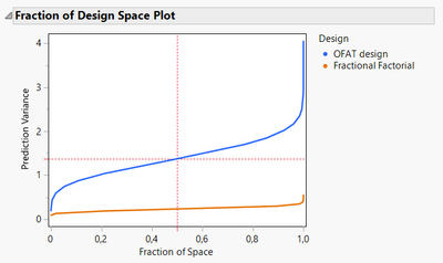

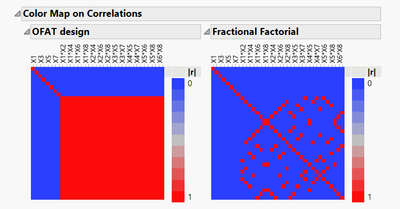

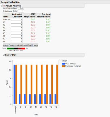

You can also answer your question by creating an OFAT design and compare it to a fractional factorial design (with 16 runs, you would have the possibility in the case of the DOE to fit some 2-factors interactions, compared to the OFAT "screening") :
  • Power analysis : Much higher possibility to detect significant main effects compared to OFAT
  • Prediction variance over the experimental space : Better repartition of the runs in the experimental space, so lower prediction variance
  • Correlations/aliases between terms : With OFAT design, no possibility to detect interactions (aliases)
You can reproduce the design evaluation and comparison with the datatables in copy.
