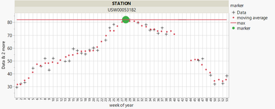

How about combining Col Max (to find the Peak) with Col Moving Average (to stretch the search window)
In addition:
  • to mark the peak position, compare individual values with the maximum value
    quick & dirty:
    - maybe: 2 matches
    - maybe [but unlikely]: a wrong match with the max value of another station
  • for Weekly Weather Data, one has to invest some extra effort:
    for every station some weeks are missing  - so to search within the correct window, one has to inform Jmp about the missing data via split & stack (works as none of the weeks is completely missing).
dt = Open( "$SAMPLE_DATA/Functional Data/Weekly Weather Data.jmp" );
half_window_size = 2;
dtsplit = dt << Split(
	Split By( :week of year ),
	Split( :TAVG ),
	Group( :STATION ),
	Remaining Columns( Drop All )
myNames=dt split << get column names();
myNames= myNames[2::Nitems(myNames)];
dtstack = dtsplit <<
Stack(
	columns(myNames)
New Column( "window",Formula(Col Moving Average( :Data, 1, half_window_size, half_window_size, :STATION )));
New Column( "max_window",Formula( Col Maximum( :window, :STATION ) ));
New Column( "marker",Nominal,Formula( :window == :max_window ));
:Label << Set Data Type(Numeric) << set name ("week of year");
Graph Builder(
	Variables(
		X( :week of year ),
		Y( :Data ),
		Y( :window, Position( 1 ) ),
		Y( :max_window, Position( 1 ) ),
		Group X( :STATION, N View Levels( 1 )),
		Overlay( :marker )
	Elements(
		Points( X, Y( 1 ), Overlay( 0 ) ),
		Points( X, Y( 2 )),
		Smoother( X, Y( 3 ) )
In addition:
    quick & dirty:
    - maybe: 2 matches
	Split( :TAVG ),
	Group( :STATION ),
Stack(
	columns(myNames)
Graph Builder(
	Variables(
		X( :week of year ),
		Y( :Data ),
		Overlay( :marker )
	Elements(
		Points( X, Y( 2 )),
