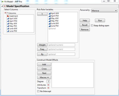

Using the "Cholesterol.jmp" sample data file and running the Fit Model platform with MANOVA personality, I was a bit confused as to why my Partial Covariance matrix did not identically match my Covariance Matrices in MATLAB and MS Excel.
Here is the JMP output:

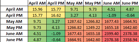

Here is calculating the Covariance Matrix in MS Excel:
Cov(x,y) = (1/(N-1))*sum((Xi-Xbar)*(Yi-Ybar))
N = 20 (patients)

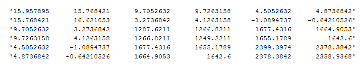

Here is the same output as MS Excel in MATLAB using the cov(x, y) function:
Maybe I am not understanding what the partial covariance matrix is, but shouldn't it be identical to the covariance matrix?
