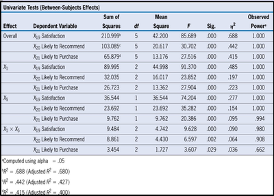

I am trying to go thru in JMP and create a Univariate tests (Between-subject Effects) . i have 3 effect variables, names X1, X2 and X1 x X2 and three dependant variables X19, X20 and X21.
here is a screen shot i am trying to duplicate in JMP.
However, in making JMP and reading thru Multivariate-Methods_v15.pdf, i cannot seem to locate the procedure syntax for creating the above representation.
Any advise or links would be useful.
thank you
Nick

I assume that you X1, X2, X19, X20, and X21 stored in separate data columns with those given names and correct data type and modeling type.
  1. Select Analyze > Fit Model
  2. Select Personality > Manova
  3. Select X19, X20, and X21 > click Y
  4. Select X1 and X2, click Macros and select Full Factorial
  5. Click Run
  6. Select Univariate Tests Also
  7. Click Choose Response and select the appropriate kind
The documentation you cited provides a description of each kind of response to help you decide.
By "syntax," I assume you are referring to the JMP Scripting Language. A script is not necessary. If a script is desired, perform the interactive steps given above, click the red triangle and select Save Script > To Script Window.

i did that but i had to use the identify. The  repeated measures did not provide me the multivariate answers i needed. And the univariate did not function.
I used the least squares to determine the effect tests for the above.
The problem is that JMP has not documentation on how to use MANOVA. Unless you can show me the procedures that function for the various parts of the MANOVA.
