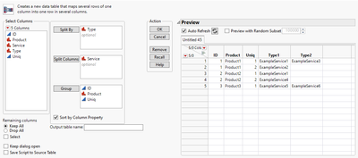

If I remember correctly this is by design (which is a bit annoying). JMP17 seems to have new warning message which I think is related to this:
One option to avoid this can be to add extra column to your original data table which has supporting running number which you can use while splitting (JMP17 has preview)
In this case I used following formula for Uniq
Col Cumulative Sum(1, :Type, :ID, :Product)
After removing Uniq column
ID Product Type1 Type2
1 Product1 ExampleService1 ExampleService3
1 Product1 ExampleService2
2 Product2 ExampleService1
2 Product2 ExampleService4
3 Product3 ExampleService5 ExampleService6
See also discussion hereDoes Split-platform work correctly?
