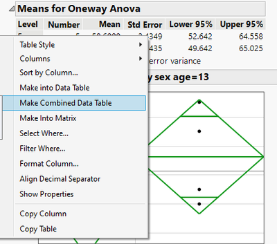

There is also a "fun" version to do this :)
with
20 analyted, 5 areas  -> :age
sampling event -> :sex
just run the script and then right click on one of the Anovas and select Make combined Data Table
Names Default to Here(1);
gb = dt << Graph Builder(
	Size( 437, 413 ),
	Graph Spacing( 4 ),
	Variables( X( :height ), Y( :weight ), Overlay( :sex ) ),
	Elements( Points( X, Y, Legend( 1 ) ), Smoother( X, Y, Legend( 2 ) ) )
Oneway(
	X( :sex ),
	Y( :height ),
	By( :age ),
	SendToByGroup( Bygroup, Y( :height ) ),
	SendToByGroup( Bygroup, X( :sex ), Means( 1 ), Mean Diamonds( 1 ) ),

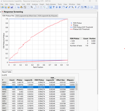

I believe the easiest way to handle this is to use the Response Screening Platform
     Analyze=>Screening=>Response Screening
It gives you the One Way ANOVAs in a table format
Jim
