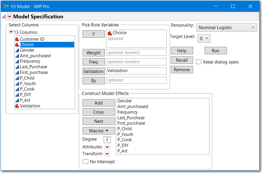

If you have JMP 14, here is the dialog. Note Choice is nominal. If not, follow the instructions, to select rows with Holdout and select Rows > Hide and Exclude. Then use Fit Model and it will look the same except for the Validation field.

No as Validation. I think a Validation is a JMP PRO feature.  So if  the Validation button does not appear, before, running the Logistic regression from the main menu select Rows >  Row Selection > Select Where ( same as CTRL + Shift + W ) and a dialog will appear. Select Validation and type Holdout, as shown below, then OK. Then select Rows, Hiide and Exclude. Then run your logistic regression. After Running if tiy save the probability model, the predictions for Holdout will also be computed.
