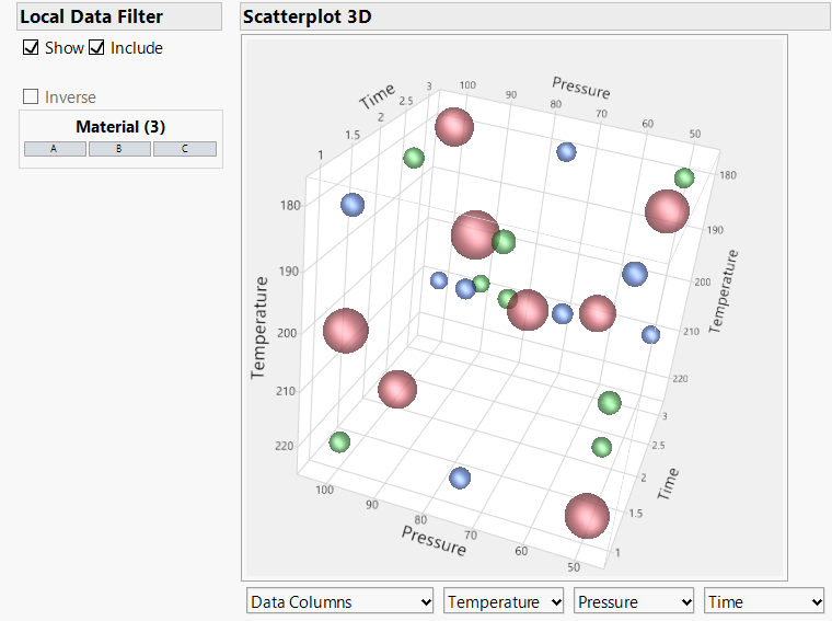

I vaguely remember that there is a way to look at Scatterplot and data table more interactively.
For instance, below I selected 4 rows that contain the variables on data table. I would like to have these conditions highlighted in the scatter plot on the right.

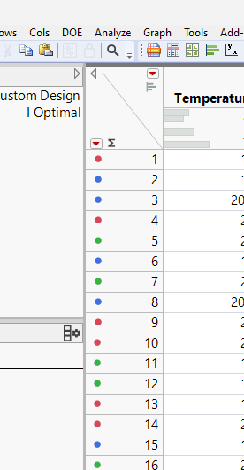

Hey BJK,
I neglected to mention that I set the row states in the underlying data table to achieve that effect.
Select all the rows in the data table and then choose Rows > Markers to modify the graph markers. I like using the spherical points for this, but play around with other options.
The other thing I did was assigning different colors to the three different values for the Material. Select the Material column in the data table then choose Rows > Color or Mark by Column.

    I think when you select rows those will be slightly bigger in 3D scatterplot. If that isn't enough, you could create a Numeric, Nominal formula column with
    Selected()
    as the formula. Then when you run scatterplot use that as the Coloring column (Column 6 in my case). Do note that this will most likely add extra "lag" to your 3d scatterplot when row selection is being changed
    -Jarmo
    Re: Linking data table with Scatterplot and question in RSM
    Agree with @jthi . Also, I find that it helps to modify the marker size and marker quality settings (right-click in the scatterplot and choose Settings...). Data table with script attached.

    Hey BJK,
