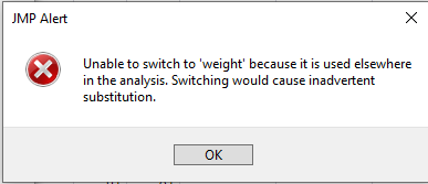

There can be still a collision for "weight". But if one tries to set both column switchers to "weight", this is automatically detected and prevented.Holger_0-1656067108104.png

If one column switcher tries to change multiple elements in graph at the same time one of those will be removed and this will be printed to log with the removed column name:
Some chosen columns were used in the analysis. The following columns were dropped from the selection list to avoid inadvertent substitution.
height

In earlier versions of JMP, column switcher would switch out all instances of the chosen column. So if you had a fit y by x, if you selected a column for the vertical axis that was the same as 'x', then for all subsequently chosen columns, the x and y would both be replaced. In recent versions of JMP, they've prevented this with the alert you mention. The history behind it tells me column switcher is not tied to an axis or grouping value, rather it tries to replace all instances, and the new versions of JMP are just preventing the collisions.
I get the same alert with the code you posted above.  If you need to do this, consider scripting something with two list boxes. When a different column is selected, delete the plot, get both x and y columns, and redraw the plot. you can use this as a reference.
