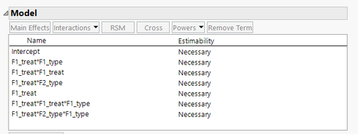

Please show us the design you are using in this analysis, the original full model (so we know what are the terms), and the singularity report.

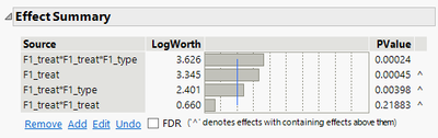

When I fit the model it I have the following significant effects

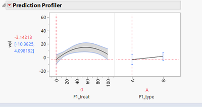

However, the prediction profiler has the response being dependent on the F1_type when F1_treat = 0. This is the part that I cannot understand, given that nowhere in the model does F1_type appear in the absence of F1_treat.

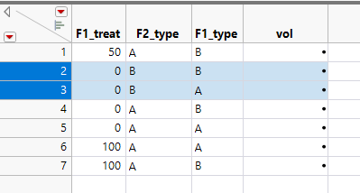

 For example, running the custom DoE tool with everything the same but with the restrictions removed and 0 repeats chosen the following design results. The highlighted rows are essentially repeats as at F1_treat = 0 then the F1_type can have no effect, the same is true of the two rows below those highlighted. Repeats are obviously no bad thing, I just use this as an example.
