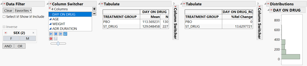

The example uses the AdverseR data from the JMP sample data. The objective is to produce a dashboard like this:
You can see there is a Data Filter on SEX. And there is a column switcher that switches the "response" variable that is summarised in the two Tabulate reports and the Distribution.
The first Tabulate (left) gives the Mean response for each Treatment Group.
The second Tabulate (right) gives the mean % change in response for each Treatment Group relative to the PBO group. This runs from a summary table ("dtSumm") of the means of each response for each Treatment Group.
The problem is that the Data Filter works on everything apart from this second Tabulate report. What would be ideal is if dtSumm could summarise only the data that meets the Data Filer criteria. And dtSumm would be re-created when selections in the Data Filter change.
Is that possible?
