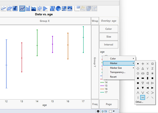

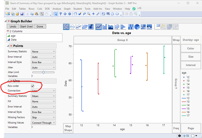

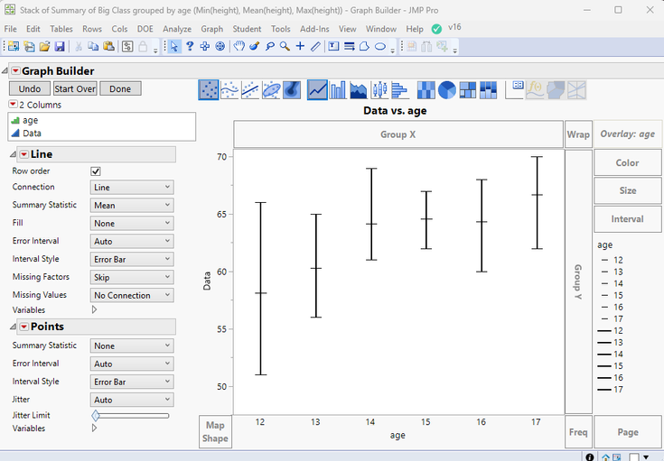

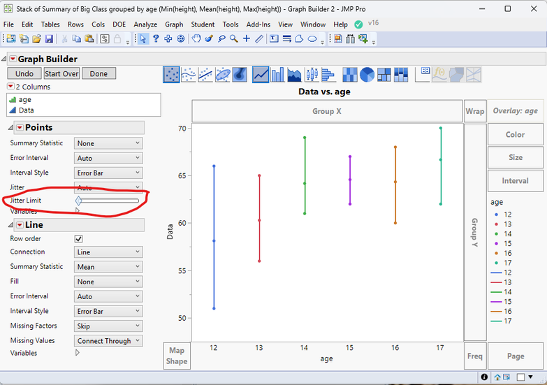

txnelson
Re: Lines connecting data points in graph (JMP v. 16)
Using JMP 16 I created the following graph

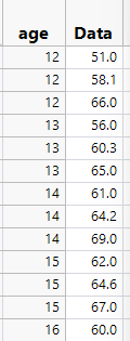

The data table has 3 data points for each age
I opened Graph Builder and dragged the Data column to the Y drop area, the Age column to the X drop area and I also dragged the Age column to the Overlay drop area
I then added a line and selected the Row Order check box
( adjusted the Jitter Limit for the Points
It then just became a matter of changing the marker and the marker color for each of the legend setting
