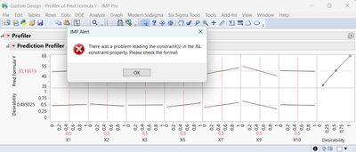

I might have found a simple solution to help by mimicking your situation. I have the same problem when I try to use the Prediction Profiler and only 7 out of the 10 variables are in the Prediction formula/model :

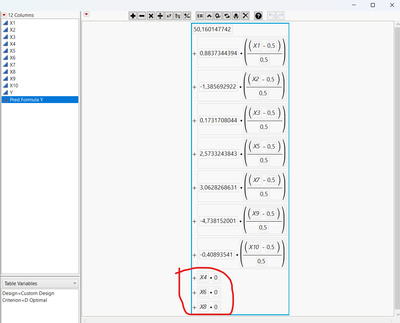

Here is the trick: You can save the prediction formula of your response with 5 variables, and then modify manually this prediction formula to add other removed variables and give them a coefficient of 0 like this :
Running the Prediction Profiler on this modified prediction formula should remove the warning message and lets you use it normally :
