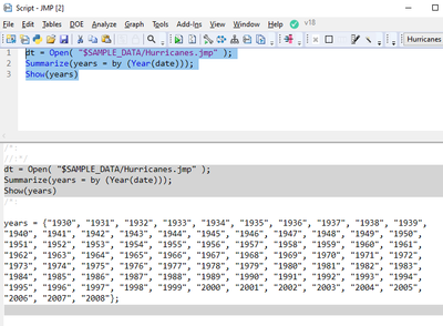

hogi
Level XIII
Re: JSL code & Summarize help
  I  have a script that had been working last month
maybe due to a pre-existing column?
hogi
Level XIII
Summarize works with Transform columns:
dt = Open( "$SAMPLE_DATA/Hurricanes.jmp" );
dt << Transform Column( "tmp", Formula( year(:date) ) );
Summarize(years = by (tmp));
//dt << Delete Columns( :tmp );
Show(years)
Don't worry if you forget to delete the transform column, it will be gone after the next "open".

hogi
Level XIII
For Hurricanes.jmp, it works due to the column :year.
JMP reroutes the year(:date) to :year ?!?
SDF1
Hi @hogi , maybe. I have no clue, and don't understand why JSL would do something like that. I just tested that theory out, and sure enough, the Summarize command did NOT work because the column :Year was gone. So strange! And, even though the :Date column is a formula in the Hurricanes.jmp file, it doesn't matter. If the formula is removed it works just fine, but if the column :Year is deleted, it no longer works. I don't understand the JSL logic behind that, but that's the way it is.
