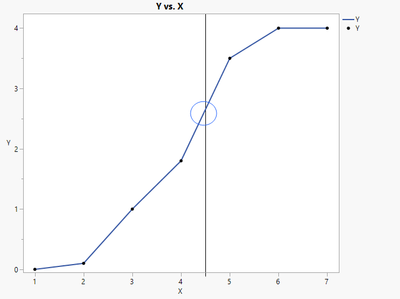

How can I extract the estimated value of of y @x=4.5? This is a simplified example of the problem i am facing.

There are a number of ways, but I would: Run the fit Y by X platform.  Then fit the appropriate curve (I did a cubic).  The from the red triangle next to the "Polynomial fit Degree=3", Save Predicted. This will save the model to the data table.  Then just enter 4.5 in an open row for X.  I attached the data table with the script and prediction formula saved.  You can also re-run with a different model.
Re: How to extract (predict) value in JMP?
Another approach, but similar. It looks like you just did a piece-wise fit. In other words, straight lines between each data point. So if you truly want the mid-point of 4 and 5, exclude all rows in the table EXCEPT 4 and 5. Use Fit Y by X and fit that straight line and follow @statman 's suggestion of saving the prediction formula.
Or you could use Fit Model to fit between 4 and 5 and use the prediction profiler to drag the X-value to get the most flexibility.
So many choices depending on what you are really trying to accomplish.
Dan Obermiller
txnelson
One way is to use the Crosshairs tool
Another way is to use the Interpolate() function in JSL to find the value

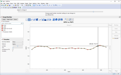

Do you need the exact value at 4.5 - or is this an example and you want to get a dynamic reading depending on the current position of the mouse?
Here is a wish to give a Crosshair the ability to snap on a smoother-ed curve
You could vote there and add the comment to provide a similar functionality also for line graphs.
