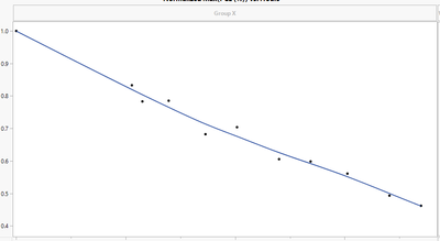

Line turns to smoother when created from JSL script.
Can anyone help me identify what am I doing wrong here
Graph Builder(
	Size(984, 563),
	Show Control Panel(1),
	Variables(X(:X), Y(As Column(Y))),
	Elements(Line(X, Y, Legend(3), Connection("Curve")), Points(X, Y, Legend(4)))
My line turns to a smoother , I want it to touch all the points with a curve connection . I created the chart from console of JMP and it worked fine , I even copied the JSL from the session script but turns out whenever I run it through JSL it gives me a smoother .

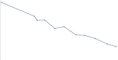

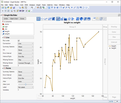

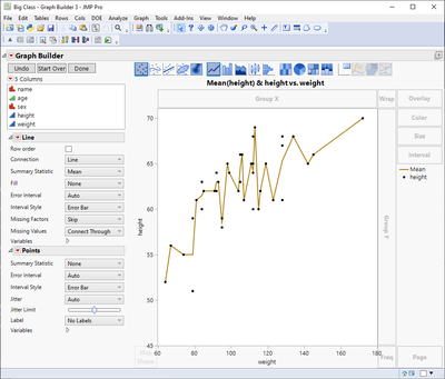

You are using Curve connection and not Line so that gives you smoothing. Also it might not be able to connect all the points if there are many values for same X-axis values unless you enable Row order.
Without row order
With row order (I did sort the data by weight first)

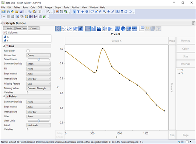

Re: Line turns to smoother when created from JSL script.
This is what I achieve when using code - .
But when manually I add a line
Next - I change the connection to curve
I achieve what I desire . A curve touching all of my points .
So how can I achieve this via my code?

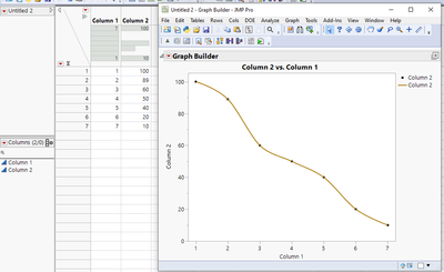

Smoother (with points) is the default for some column selections, that could be the reason why JMP is using it for your graph. How does JMP created script look like if you get it from the smoother version?
For me this seems work ok.
Names Default To Here(1);
dt = New Table("Untitled",
	Add Rows(7),
	Compress File When Saved(1),
	New Column("Column 1", Numeric, "Continuous", Format("Best", 12), Set Values([1, 2, 3, 4, 5, 6, 7])),
	New Column("Column 2", Numeric, "Continuous", Format("Best", 12), Set Values([100, 89, 60, 50, 40, 20, 10]))
gb = dt << Graph Builder(
	Size(528, 454),
	Show Control Panel(0),
	Variables(X(:Column 1), Y(:Column 2)),
	Elements(Points(X, Y, Legend(3)), Line(X, Y, Legend(6), Connection("Curve")))
-Jarmo
This doesn't work for me .
I tried it again .
I did not create a smoother manually . I created Line and added points to it and changed it to curve. Copied the script (same as the one in description) . But the same script is creating smoother not Line.
Q- When you run your script, what do you see on the control panel on the left side Points and Line? or Points and Smoother? For me , I see points and smoother on running my Line script.
Can you try adding more points to your code little in zigzag form and then run your script ?

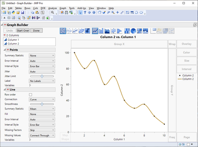

Which JMP version are you running? I'm running 18.1.2. Did you try running my script? Can you provide your data table?
	Add Rows(10),
	New Column("Column 1", Numeric, "Continuous", Format("Best", 12), Set Values([1, 2, 3, 4, 5, 6, 7, 8, 9, 10])),
	New Column("Column 2", Numeric, "Continuous", Format("Best", 12), Set Values([100, 80, 90, 60, 70, 40, 30, 35, 20, 10]))
-Jarmo
