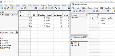

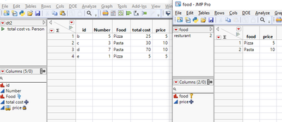

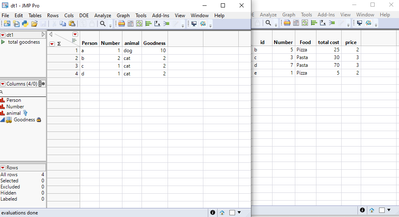

Here i have 2 data tables, each with some data and scripts. I now want to combine them into one big data table with everything

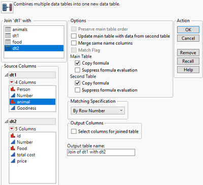

The best choice seem to be do a join, and this does work.

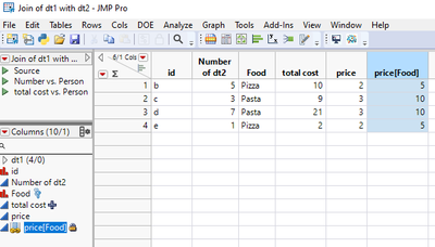

the formula columns still work, the name collision is handled and the saved table scripts are even updated to the changed column names.

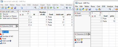

Except the original tables were virtually joined to other tables.
this link is lost on joining the tables
simply adding the link back does not work, as the formula columns, that relied on a linked column, still refer to the old column
This example is quite simple, so just manually updating would be possible.
the real use case would be more complicated, so trying to fix the table after joining does not seem feasible.
