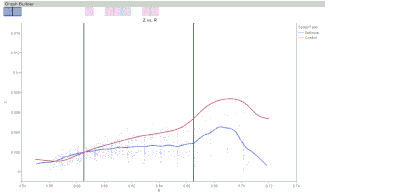

I am wanting to fit a straight line in graph builder, but only for a specified range of data.  I want my chart to show the whole spectrum of data and the smoother line (as shown below), but also a fit line only using the range of the data between the black lines.  I would also like to get the equation of the line and show it on the graph if possible.

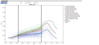

Great.  Thank you very much.  I think I am going with option 2 with a slight modification.
I couldn't get option 1 to show both sets of data on the same Y axis at the same time in GB.  With option 3, I couldn't find a way to get a smoother line in the Fit Y by X (and if I could it didn't seem like it would include the excluded data, which I wanted for the smoother line).  I ended up going with option 2, except instead of adding 2 additional columns I only added 1 that only had the data I wanted to fit the line to.  Then I put my original Y and my new Y into GB and fit a line only to the new Y as you described.  If I did 2 new columns the smoother line was not correct for the middle section.
