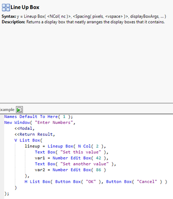

Line Up Box() takes NCol() as its first argument.  I use it in JMP 18 to display some reports.
*edit
Never mind.  I see you sent the message later to the box.
