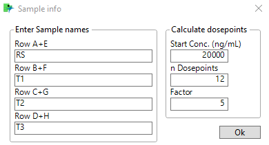

In my script I included a ‘sample info’ pop-up window in which operators can identify sample locations (Row x + x) and enter the desired dose-range for these samples. And this is where my struggle comes in!

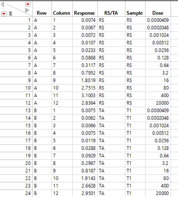

What I want it to look like (see 'Dose' column, manually entered for this example):

I am working in JMP 18, my script for the sample info pop up so far:
nw = New Window( "Sample info", << Modal,
	H List Box(
		Panel Box( "Enter Sample names",
			V List Box(
				Text Box( "Row A+E" ),
				AE = Text Edit Box( "", << Set Width( 200 ) ),
				Text Box( "Row B+F" ),
				BF = val2 = Text Edit Box( "", << Set Width( 200 ) ),
				Text Box( "Row C+G" ),
				CG = val3 = Text Edit Box( "", << Set Width( 200 ) ),
				Text Box( "Row D+H" ),
				DH = val4 = Text Edit Box( "", << Set Width( 200 ) );
		Spacer Box( Size( 10, 10 ) ),
		V List Box(
			Panel Box("Calculate dosepoints",
				V List Box(
					Text Box( "Start Conc. (ng/mL)" ),
					Conc = Number Edit Box(  ),
					Text Box( "n Dosepoints" ),
					nDP = Number Edit Box( 12 ),
					Text Box( "Factor" ),
					xF = Number Edit Box( 0.2 ),
			Spacer Box( Size( , 8 ) ),
			H List Box(
				Spacer Box( Size( 77, 1 ) ),
				Button Box("Ok",
				val1 = AE << Get text ();
				val2 = BF << Get text ();
				val3 = CG << Get text ();
				val4 = DH << Get text ();
				val5 = Conc << Get ();
				val6 = nDP << Get ();
				val7 = xF << Get ();
					Current Data Table() << New Column( "Sample", Character, "Nominal",
						Formula(
							Match( :Row,
								"A", val1,
								"E", val1,
								"B", val2,
								"F", val2,
								"C", val3,
								"G", val3,
								"D", val4,
								"H", val4
					Current Data Table() << New Column( "Dose", Character, "Nominal",
						//Formula( ????

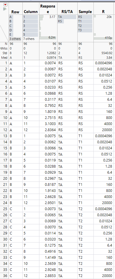

Almost!
I adapted your script a little and was able to calculate the right dose range for 1 of the replicates! (see attachment). The other replicate should have the same values (i.e. 20.000 - 0.0004 ) but instead keeps dividing the last result of replicate 2.
So, for Sample 'RS', located in Row A (replicate 1) and E (replicate 2), Row E values range from the desired 20.000 to 0.0004 range, but for Row A the range is 0.0008 - 1.67e-12.
