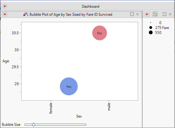

Hi Andy,
This may not be what you want, but maybe it will inspire someone to offer a better idea.
To build the legend:
  1. I built a Graph Builder graph with a size role using the same column as the bubble plot.
  2. I shrunk the graph and removed the border and title.
  3. I deleted the Graph Builder title, which removed the Graph Builder Outline box.
Then I combined windows to create a dashboard.
If this works for you, please let me know if you need more details steps.
~John

Hi,
Thanks for the idea.
What I am playing with is this where I have created dummy datapoints, red circles, (again not my preferred option) and placed them in line with the Y axis grid. So the one cross at 1 is 1, crossing at 10 = 10,....  I will need to add text in presentation deck to explain.
Andy
