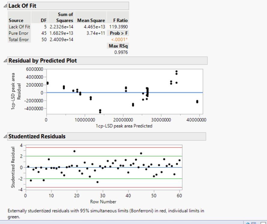

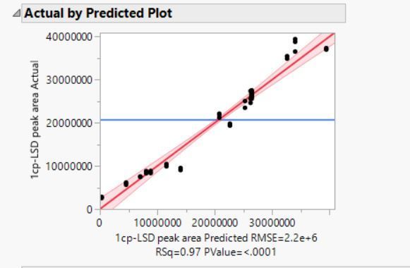

Greetings.
I am a PhD student from non-engineering background and has been using JMP 17 Pro for the past one month. This is my first-time using JMP software and I made self-study through JMP website, YouTube, and Chemistry World to be able to arrive to RSM but I am struggling to troubleshoot the lack-of-fit issue. I started off my optimisation process with fractional factorial design (2^6-2) to screen the important factors using 2-level screening. From there, I made a face-centred composite design for three significant factors using a slightly wider trajectory with six additional centre points, in triplicates with random order of run using RSM in classical design. The output was 60 experiments including 18 centre points for multiple compounds measuring signals. I only had two compounds with insignificant lack-of-fit, the rest of them P<0.001. My question is:
1. How can I check if the high number of centre points causing the biasness in the modelling for other compounds?
2. Is it okay to remove the centre points and keep all other response for modelling?
3.How to check the if the model in the JMP fits the quadratic or any higher order polynomial to adjust it before tweak the instrument.
4. I read @Phil_Kay suggested the use of Best Subset and SVEM Lasso in Gen Reg for similar issue in another post. Where can I find more detail about data analysis using those two approaches to fit the RSM to get desired lack-of-fit in DOE?
5. If that is not the case, how to augment the experiment to achieve desired the lack-of-fit?
Please assists me.
Thank you

  3. It may be difficult to help you with only the two screenshots you provided, as I'm not entirely sure how you build your DoE and how you did the modeling. But you can see which terms are entered in the model in the "Effect summary", "Parameter Estimates" or "Effect Tests" panels (available in the red triangle next to each response, and then in "Regression Reports" or directly in the red triangle menu for "Effect Summary"). If you have done an RSM design like CCD, you should be able to create a model with all main effects, 2-factors interactions and quadratic effects.
    Do you already have these type of terms in your model ? Which ones are significant ? It would help having the JMP table to see if the model could be refined before thinking about higher order terms or something different.
    From your residual plots (and actual vs. predicted), it seems there is some curvature that may not be properly handled by your current model, so you may check if you have interactions and quadratic effects in the model. If you already have them, maybe higher order terms may be required.

I think I know what you mean by asking if the centre points are biasing the lack-of-fit statistic. The 18 CPs will have a strong influence on the calculation of pure error, which is used in the lack of fit test. If the error variance at the centre of the design is not representative of the error variance across the design as a whole (you might be able to think of reasons why this would be the case) then the centre points will be biasing the lack of fit test, at least to some degree. This is one of the reasons why some people prefer not to use centre points. However, it is also entirely possible that the centre point repeats are representative of the error across the whole factor space.
Are the triplicates really independent runs? That is, did you completely reset factors between the first and second of each triplicate, and between the second and third of each triplicate? Or is each triplicate just 3 repeated measures from the same preparation sample? If they are not truly independent runs, that would also affect the validity of the model and the lack of fit test, unless you add a random effect term for "preparation".
You should also consider that your lack of fit test could be completely valid and what that means. The lack of fit does not tell you whether your model is wrong or right ("all models are wrong"). Please don't just use lack of fit significance as a tick box exercise. Consider what it really means. Consider the size of the error terms and question whether that fits with your experience of the system. If lack of fit is "significant", is it actually important - it might not be.
If you think that the lack of fit is valid and important then you might want to look to add higher order terms to your model. I can't see your design, so I don't know what models will be possible to estimate. But you might want to test cubic (X1*X1*X1) and/or partial cubic (X1*X1*X2) terms in your model.

Both Victor and Phil have provided excellent advice and some great questions.  Try this, create a subset of the data table for just the center points.  Sort them in run order.  Plot them, you might use a X, MR chart or graph builder.  Are there any patterns or unusual data points?  Is the variation seen in the center points representative of "typical" variation in the process?  You likely need some SME help to analyze the data.

In addition to the other great comments form @Victor_G  , @statman  , and @Phil_Kay  , the stud residual plot looks, perhaps, like there is some blacking going on that is unaccounted for; for the first 30 or so runs the residuals are skewed low, the next 20 or so are skewed high. Were all runs done all in one day? Across several days? Different analysts etc?

Both pictures show plots that exhibit patterns from lack of fit. Notice how close replicates are compared to the deviations from the identity line in the Actual by Predicted plot or the deviations from Y = 0 in the residual plot? How was replication performed? Were the runs fully randomized? (Each run was selected in random order, and all the factors were reset before the next run?)
