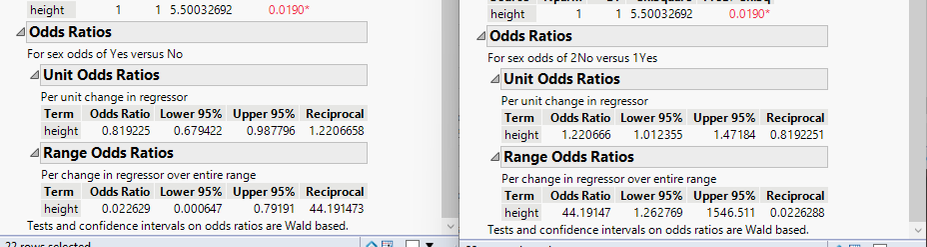

I am running JMP 17  on Windows and it appears that the Odds Ratio order is dependent upon the Alphabetic order of the data.  Data whose values of the Y variable were "No" and "Yes"  was calculated "Yes vs. No".  The same data, with the data changed to "2No" and "1Yes" was calculated "2No vs. 1Yes"
I ran the JSL from the Statistics Index example for Odds Ratios, just changing the values for the Sex column in the Big Class data table from "F" to "Yes" and then to "1Yes" and for "M" to "no" and then to "2No"

This platform respects the Value Order column property. You can define this property as another way to tell JMP which ratio you want.
