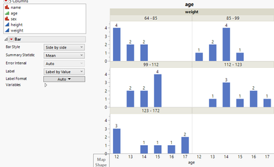

Your comment helped me figure out what was going on. Basically, I am allowing the user of my JSL script to use most of the Graph Builder functionalities, including Wrap and Overlay. For overlayed bar graphs, I prefer the stacked bar style over the side-by-side style, so in JSL, I made the graph stacked style regardless of whether the user used the overlay. When I added the labels, I did not realize remember that I changed the bar style, and apparently the bar style changes the default label positions. I attached a couple of graphs that show that.
                                        Side-by-side                                                                     Stacked
Thanks for the help,
Riley
TLDR: My bar style was stacked and not side-by-side (the default)

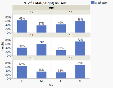

I'm not seeing the behaviour that you describe. When I plot a bar chart with Percent of Total Count as the Y and a Wrap variable, the labels are on the top of the bars by default:
Which version of JMP are you using (I used 16.2.0)? Can you provide some non-sensitive example data?

Thanks! That makes sense because, of course, if you had stacked bars you would have to have the labels in the centre of each stacked bar.
