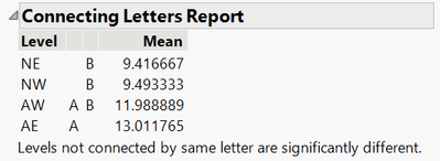

Right-click on the Connecting Letters Report table and choose Sort by Column. Choose the Mean column and check the Ascending checkbox.
Here is what a sorted report looks like on a sample dataset.
