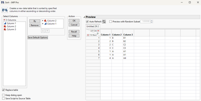

I am not sure this exactly meets your needs, but the Value Order rder of your Column 3 can be set based upon the Row Order of your data.  To illustrate what I am attempting to show, do the following to your data table
  1. Go to     Tables=>Sort and sort the data by Column 2,Column 1txnelson_0-1711713033687.png
    As can be seen, the Column 3 is in the order based upon the Value Order of Column 2
  2. Click on OK to reorder the data

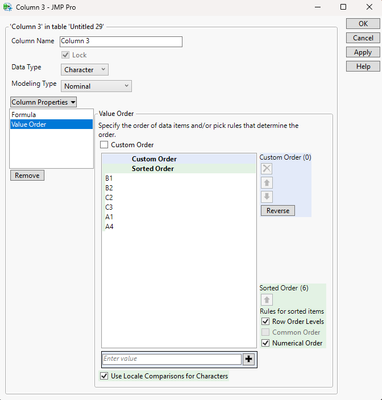

  3. Now select Column 3 and right click on the header and select Column Properties=>Value order.  A message box should come up and ask about alphanumeric ordering, just click on No
  4. At this point, one could move the Custom Order values around to meet the order you have specified, however that could be real tedious.  But a simple trick can be used to have JMP do that for you.
    1. If you Uncheck the Custome Order box and check the Row Order Levels boxtxnelson_1-1711713825036.png
      The Value Order will change to the order of Column 3 in the data table.
    2. So now, if you set the check boxes back to Custom Order checked and Row Order Levels unchecked, the Custome Order is now set to the order found in the data tabletxnelson_0-1711714512196.png
    3. Click on OK and when you sort on Column 3 it will sort as you specified

Re: Keep column customised order after concatenation with other columns
Thanks, that's exactly the kind of tip I was looking for!!! I'd done the method where I manually specified the customer order but it was really time-consuming
