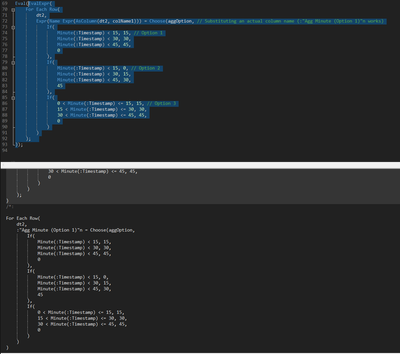

There is almost never need to start messing with ":" (adding ":" as a string) and even less with Parse(). When you are setting values to a column with For Each Row you can do something like this for example
For Each Row(
	dt2,
	Column(dt2, colName1)[Row()] = Choose(aggOption, // Substituting an actual column name (:"Agg Minute (Option 1)"n works)
		If(
			Minute(:Timestamp) < 15, 15, // Option 1
			Minute(:Timestamp) < 30, 30,
			Minute(:Timestamp) < 45, 45,
			0
		If(
			Minute(:Timestamp) < 15, 0, // Option 2
			Minute(:Timestamp) < 30, 15,
			Minute(:Timestamp) < 45, 30,
			45
		If(
			0 < Minute(:Timestamp) <= 15, 15, // Option 3
			15 < Minute(:Timestamp) <= 30, 30,
			30 < Minute(:Timestamp) <= 45, 45,
			0
This isn't the only option but it is very simple. If you really want to start messing with expressions, this is one way
Eval(EvalExpr(
	For Each Row(
		dt2,
		Expr(Name Expr(AsColumn(dt2, colName1))) = Choose(aggOption, // Substituting an actual column name (:"Agg Minute (Option 1)"n works)
			If(
				0
			If(
				45
			If(
				0
One nice thing with EvalExpr (same deal with Substitute) is that you can easily see the expression which will be evaluated if Eval is used, but selecting the EvalExpr() part and then running that
-Jarmo
For Each Row(
	dt2,
		If(
			0
		If(
			45
		If(
			0
Eval(EvalExpr(
	For Each Row(
		dt2,
			If(
				0
			If(
				45
			If(
				0
-Jarmo

jthi
Re: Just when I thought I understood Eval and Expr...
That is just my preferred method as use Column(dt, colname) whenever I can (you can also drop Row() and just use Column()[]). I think should also work with As Column()
For Each Row(
	dt2,
	As Column(dt2, colName1) = Choose(aggOption, // Substituting an actual column name (:"Agg Minute (Option 1)"n works)
		If(
			0
		If(
			45
		If(
			0
but in my opinion As Column() is much more annoying to use so I don't use that much... Except when I'm using it with Name Expr() and I'm trying to build something which requires you to have :col format or it just cleaner to have column in that format (like in formulas).
-Jarmo
