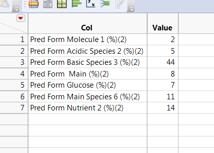

I have to join two tables  using jsl. The first table looks like this:

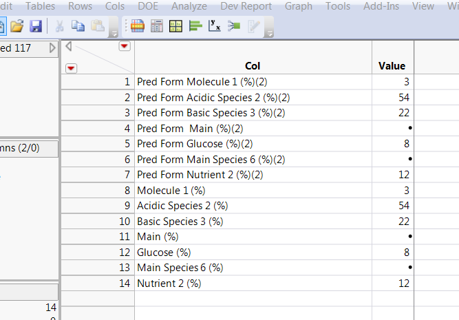

However, the second table can either be like this:
In this table, Pred Form Molecule 1 (%)(2) is the same as Molecule 1(%) and the numbers in the value column are repeated. How can I specify the join to only consider one of those values?
The second table to join can look like this:
In this case, how can I specify in the join that Molecule 1 (%) in the first table is the same as Pred Form Molecule1 (%)(2) in the table that needs to be joined.
