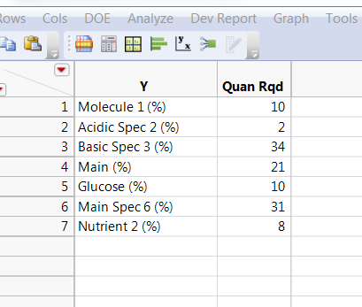

I have to join two tables  using jsl. The first table looks like this:
However, the second table can either be like this:
In this table, Pred Form Molecule 1 (%)(2) is the same as Molecule 1(%) and the numbers in the value column are repeated. How can I specify the join to only consider one of those values?
The second table to join can look like this:
In this case, how can I specify in the join that Molecule 1 (%) in the first table is the same as Pred Form Molecule1 (%)(2) in the table that needs to be joined.
The final table that I need should be something like this:
Thank you for any help.

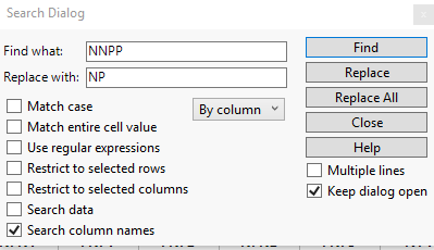

txnelson
Re: Joining tables
You can use the Search(Find) dialog to change column names, or parts of column names
Jim

pmroz
Re: Joining tables
I was suggesting recode to change values in a column, not change the name of the column.  To use the recode option, highlight the column you wish to recode, and click on Cols > Utilities > Recode (v12) or Cols > Recode (v13).
