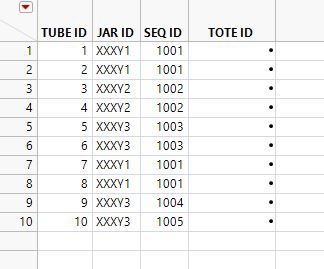

I am trying to pull a data point from one data table into another data table. Above is an example. A simple join does not seem to get me where I need to go. The data table on the left in reality is quite large(800K rows). I would like to match between the two data tables based on jar id and seq id. Then create a new column in the table on the left with the TOTE ID and populate it with data from the table on the right (which is much smaller 70k rows) with a successful match. So any given TOTE ID from the data table on the right will get used repeatedly populating the table on the left. Thank you for your assistance.

What you want to do is a simple join of the data tables.
     Tables==>Join
Below is the JSL that will do the join, however this can easily be done in an interactive mode

Thank you for the help on this! I was not checking to include non-matches. Got it working thank you.
