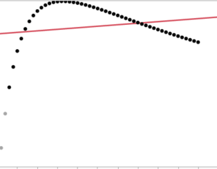

Thank you, to clarify on my question, Im trying to implement a search using functions like the maximize or minimize to find the abs max/min in the curve (with regards to dec place).

The y axis is the Rsquare values so i wanted to get the max Rsquare
