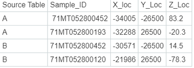

the data table "concat data table" looks like this.
the table is already open after concatenating
