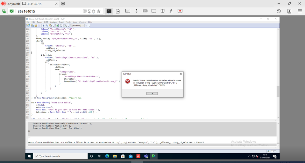

Hi,
I am trying to get data from a Access DB via SQL Query.
I configured a filter on the column StudyID. The user should insert the value in a window text box before the query execution and such value is stored in the study_id_selected variable.
It seems that the syntax of the SQL Query filter is not correct because I get the following error:
Below you can find the whole script. Could you tell me which is the correct way to write the SQL filter condition?

Re: Error on Filter Condition on SQL Query
Hello,
For debugging your jsl, you can maybe create a char variable which will contain the SQL statement and then test it directly on your db.
And if the SQL is ok and not working with
dt = New SQL Query()
you can try with
dt = Opendatabase()
Guillaume
