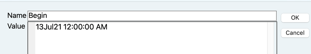

So, with that change made, we do one more thing: we add table variables. Right-click on the red-triangle near the table name, and select New Table Variable. This shows a dialog where you can name a new table variable and give it an initial value.
Doing this for "Begin" and "End" allows us to define two values (strings, in this case, but numbers work, too) that can be used just like columns in formulas and scripts. To change a value later, just double-click on it to edit.

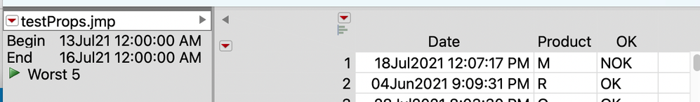

Using the same red triangle menu, we can add a new script to the data table. I've added a script called "Worst 5" and pasted the text of the script below.

Now it is easy to get the report you want:
1) Change the Begin and End values as desired.
2) Press the green button on the "Worst 5" script to get the results.
