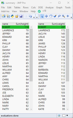

Hi Community, My intention is to create multiple table via tabulate, sort the target column in each table from largest to smallest, put them together via new window, and show the first row data in green. Below is how i did it with sample data big class, with some issues I cannot figure out why:
1. the sorting window keeps open and does not really perform the sorting
2. the tabulate platform keeps open
3.  don't know how to color cells after I put them in data table box in a new window

Here is how I was able to get your code to work:
//Data Table( "Big Class.jmp" ) << Tabulate();
//Local( {obj},
obj = Data Table( "Big Class.jmp" ) << Tabulate(
	Show Control Panel( 0 ),
	Add Table( Column Table( Analysis Columns( :height ) ), Row Table( Grouping Columns( :name ) ) )
dt1 = obj << Make Into Data Table;
obj << Close Window;
dt1 << Sort( By( :"sum(height)"n ), Replace Table, Order( Descending ) );
// Color the cells in row 1
Current Data Table( dt1 );
:name << color cells( "green", 1 );
:"Sum(height)"n << color cells( "green", 1 );
Local( {obj},
		Add Table( Column Table( Analysis Columns( :weight ) ), Row Table( Grouping Columns( :name ) ) )
	dt2 = obj << Make Into Data Table;
dt2 << Sort( By( :"sum(weight)"n ), Replace Table, Order( Descending ) );
Current Data Table( dt2 );
:"sum(weight)"n << color cells( "green", 1 );
// The only way I know to copy cell colors in a data table to a display
// window, is to move the data table with the colored cells to a journal
// Then it can be copied into a display object in a display window.
// I repeat the operation twice in the code below
nw = New Window( "summary", hls = H List Box() );
intJr = New Window( "x", <<journal );
dt1 << journal;
hls << append( intJr );
intJr << close window;
dt2 << journal;
Close( dt1, nosave );
Close( dt2, nosave );
Jim
//Local( {obj},
Local( {obj},
dt1 << journal;
dt2 << journal;
Jim
