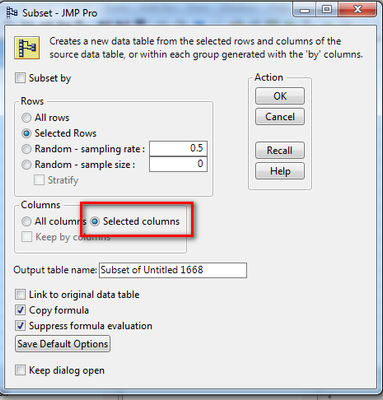

Probably a simpler solution that is easy to do manually (and script easily) is to just subset your data.
Select the Columns you want to keep and then subset with the Selected Columns(1) option.  This should also be faster than the method described above when the data table gets large, but I haven't tested it.
