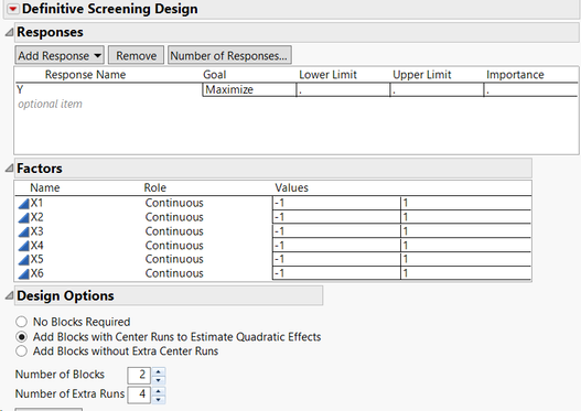

I've created a DSD DOE - 6 parameters with added blocks with center runs to estimate quadratic effects, in total of 18 runs.

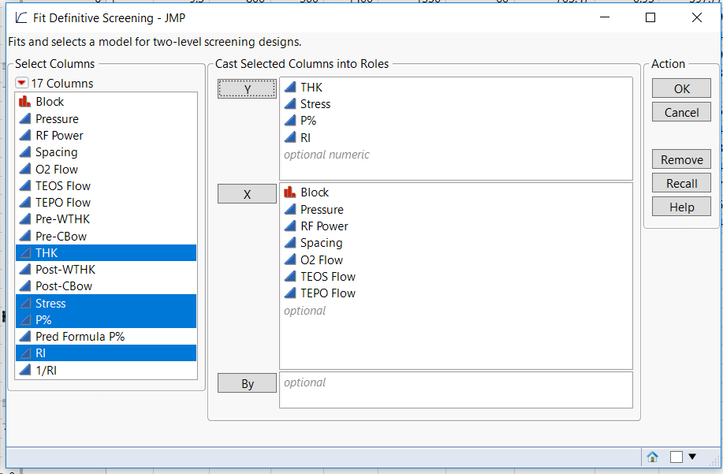

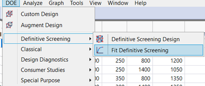

DOE run, data obtained. now come the analysis part. I use this option to analyze the DSD DOE.
The question is: should the Block be included in the X-roles area?

Yes.
You should include the block in your analysis.
The reason for including a block in your design is to account for expected differences in the response(s) between your blocks of runs that is not within your control.
You need to account for this uncontrolled variation in your model.

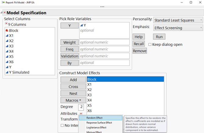

You should find that the Fit Definitive Screening analysis script in your design table will bring up the dialog with all factors and the block included as X's.
After running the Fit Definitive Screening analysis you can click Make Model to bring up the Fit Model dialog with the selected effects. At this point you should add the block as a random effect (see screenshot): Select Block > Attributes red triangle menu > Random Effect. The Method will default to the recommended REML.
This free chapter download from the book Optimal Design: A Case Study Approach talks in more detail about block effects and REML. I highly recommend this book for anyone wanting to learn beyond the basics of DOE.

"I don't understand what you mean by you added center runs?"  This is an option is designing DSDs that you can see in the screenshot from @AmirSS at the top of this thread. JMP will add center points to each block that you specify.
"The reason for no prob. statements is the model is saturated" - this is often the explanation for not seeing p-values but I do not think that is what is happening here. The model does not appear to have many effects. I believe that we have a DSD for 6 factors with 4 added runs, which would be 17 runs. Plus there will be more runs for the added center points for the blocks. So I don't think we are in the situation of having as many parameters to estimate as we have runs.
